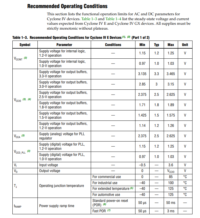

Hi Brian,
Agree on the long-term point. Bench power-up alone does not prove lifetime stress. The goal is to stay inside the documented connection / reservation rules, not only “it boots today.”
Q: Need more clarification on this: tri-state w/o pull-up or?
A: Yes. On the density where that ball is GPIO:
- In Quartus, reserve that pin specifically as "As inputs that are tri-stated" (no weak pull-up, no bus-hold). In the .pin file that shows up as RESERVED_INPUT.
- On the board, hard-tie it to 2.5 V (same net as VCCA for the density that needs that ball as power). Per AN 592 / unused-pin guidelines: RESERVED_INPUT may be connected to a high or low on the board.
- So, external hard-tie to 2.5 V + FPGA pin = input tri-stated, no pull-up. Not floating tri-state.
The Quartus migration + RESERVED_INPUT (tri-state, no pull-up) + hard-tie to 2.5 V guidance follows Altera’s published migration and unused-pin connection rules. It is the supported way to keep the pinout legal across densities. It is not a guarantee of long-term electrical behavior for a continuous 2.5 V level on a GPIO that sits in a 1.8 V (VCCIO) bank (for example with SSTL-18 / HSTL-18 on that bank). Absolute VI ≤ 3.6 V and a successful board bring-up do not by themselves prove lifetime margin.
Hi Brian,
reading Cyclone IV datasheet strictly, Table 1-15 has also to be observed. It specifies Vinh,max of 2.25 V for 1.8 V banks. Don't no why and how the spec is related to general 3.6 Vin,max in table 1-3 and 1-4. According to device handbook, PCI diode isn't used vor 1.8 V and below I/O standards.
Regards Frank

Well if you read from top to bottom:
The table for output uses VCCIO and input Max=3.6V ~ha!
If your statement holds, then the output should be a fixed number as well for generalized numbers.

Hi Brian,
I apologize for not reading your question thoroughly. I didn't realize that you asked about feeding 2.5 VCCA supply to a 1.8 V GPIO due to migration compatible pin assignment. That should always work. To be sure, you can check the respective assignment in Quartus pinout table.
I checked that Quartus indicates connection of VCCA4 (PIN_L12) to 2.5 V for EP4CE10F17 if you select migration compatibility to CE22, no matter that's in a 1.8 V bank.
