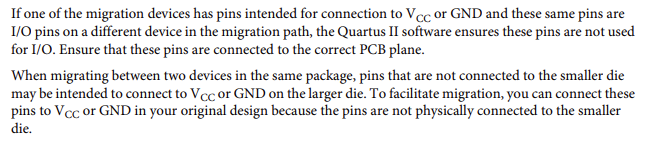

Maybe just for your information, I saw an old documentation, Quartus® II Handbook mentioning below statement:
Aqid- BrianSune_Froum3 months ago
