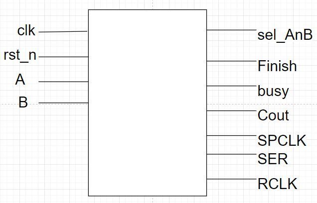

Hello everyone,
I have a question regarding Intel Quartus and its Block Editor feature. In Arduino, I can write programs in the software, simulate circuits, and even connect them to breadboards. I was wondering if Quartus has similar capabilities, such as simulating circuits on the board or customizing inputs and outputs using Verilog designs.
I would appreciate any advice or suggestions on how to achieve this in Quartus. Thank you in advance!

  • sstrell's avatar
    sstrell
    In Quartus Standard edition, you can create a symbol file (.bsf) from an HDL design from the File menu. Is that what you are looking for?
