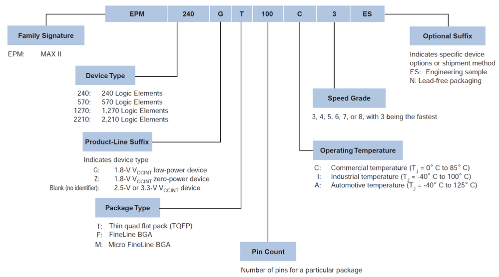

Is there any information on custom part EPM240ZXXAA available? I'm trying to find out what it is, a datasheet would be useful. I'm wondering if by chance it could be used as a drop in replacement for our usual part EPM240ZM68C7N ?

  • Hi,
    I believed the 'XX' in EPM240ZXXAA is just a random alphabet added to show that it can be any package type and pin count.
    One example of real OPN number is EPM240GM100C5N.
    Aiman

      Have you looked up this part number?
      The "XX" also does not appear in the Figure 6–1. MAX II Device Packaging Ordering Information on your datasheet.
