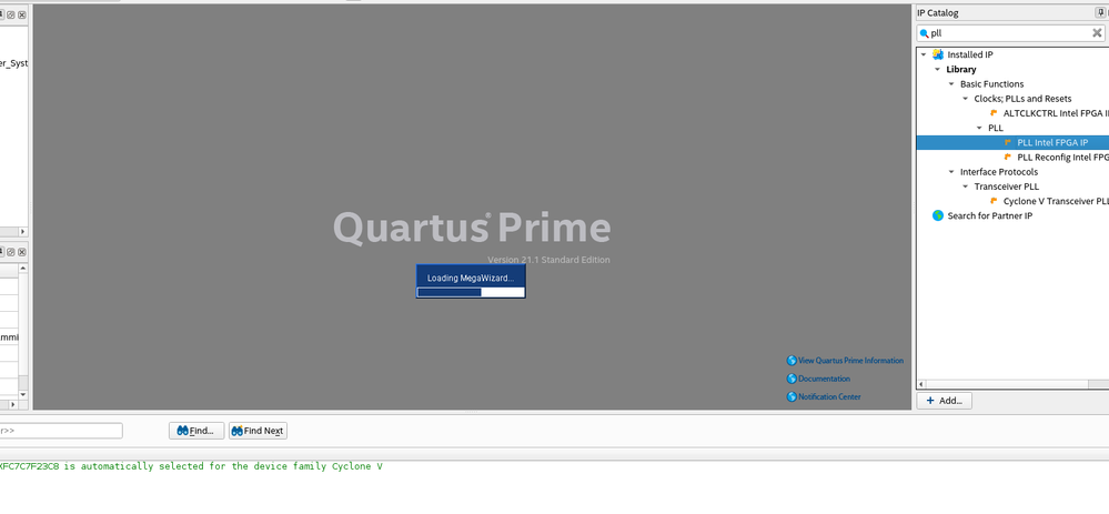

  • ShengN_altera's avatar
    ShengN_altera
    After clicking ok, have to wait for a while for the Megawizard window to pop out like this pic:
    If still there's problem for Megawizard window to pop out, try to re-installed the Quartus Tool and see.
