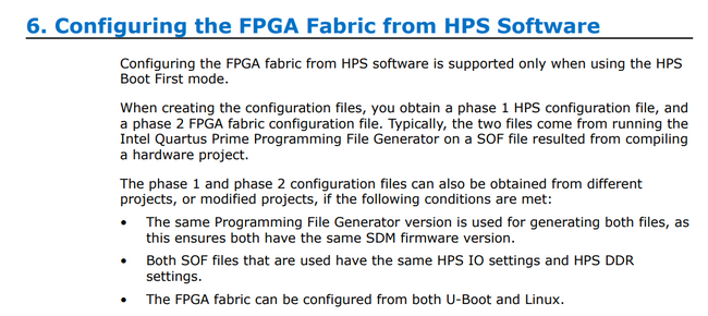

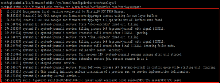

I follow the 6.2 chapter of "ug-agilex-soc-boot-683389-766161.pdf" file to configure the fpga fabric from linux. But the error is occurred:
I don't know what happened. Please help!
The following message should be told to you:

4. Match to below requirements:
Thanks very much.
