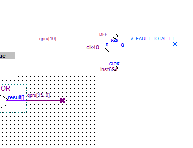

Hi all,
I am using Quartus 13.0.1 sp1 to compila a project and generate the "pof" file for a CicloneII. In one of the block diafram file (bdf) I use a signal in the form of an array bit that is no...
Leire
4 years agoHi SyafieqS,
There is NO error in compilation report. That is what susprises me. The signal "q_pru[16]" is not assigned, not connected, to any source. The problem I have is there is no error, no warning in the compilation report.
Thanks in advance,
Leire
- sstrell4 years ago
So if there's no error or warning, how do you know there is an issue? Is it not working correctly in hardware? Are you seeing something strange in the RTL Viewer or Technology Map Viewer (Post-fit)?
