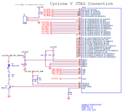

5 years agoCan't access JTAG Chain
i am developed customized Cyclone 5 device board. In that we are using cyclone 5 devices as "5CGXFC7C6F23I7" & Configuration device has "EPCQ512". I trying to download basic program via USB Blaster. ...
YuanLi_S_Intel
5 years agoThe Cyclone V device drives the nSTATUS pin low immediately after power-up and releases it after the Cyclone V device exits power-on reset (POR). As a status output, the nSTATUS pin is pulled low to indicate an error during configuration.
Can you please check if the voltage supply pin is all stable?
