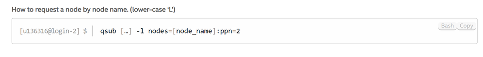

  • Hi @Wei-Chih,
    You can try the specific command as below to access the node in interaction mode:
    qsub -I -l nodes=s001-n143:ppn=2 -d .
    Hope that clarify your doubts.
    Best Wishes
    BB

    Hi BoonBengT
    It's unclear, i still don't know how to run on another job exclusive (i.e. s001-n056)
    for example i use this qsub command:
    qsub -l nodes=1:fpga_runtime:arria10:ppn=2 -d . run_fpga_hw.sh
    how to modify it to use and try s001-n056?
