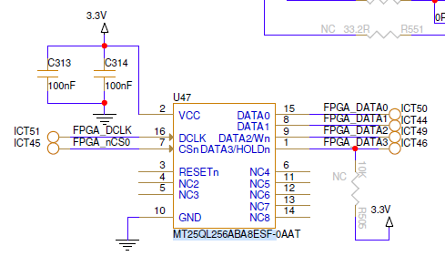

cannot add target device when in current programming mode
After compilation and generation of .pof file based on my flash (MT25QV256),
I'm trying to add it to the programmer and burn it through JTAG, but get the error:
"Cannot add target device MT25QL256 to device chain when in current programming mode.
the FPGA is cyclone V.
any suggetions?
Sasson
