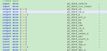

Can the EMIF IP core remaining IO be used ?
Hi : I have instantiated a 16-bit hard DDR4 controller in my project. It will occupy 2 banks and 51 IO pins. The two banks have a total of 96 pins. Excluding the 51 pins occupied by the DDR4 control...
  • allen18's avatar
    allen18
    3 years ago
    It should not be feasible, incompatible voltage standard
