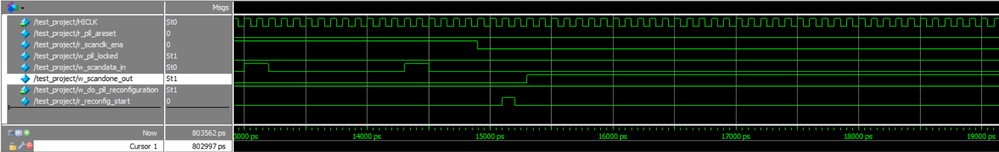

Above shows the completion of the scan line write and reconfiguration

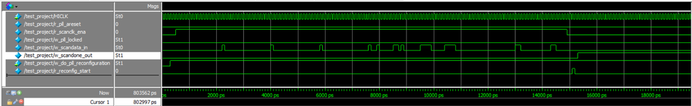

The above shows whole operation. I managed to load proper .HEX file into ROM in Modelsim, and as we see `scandone` goes high and does not fall back low in simulation (as well as in real system). Lock goes high in some time (not shown on the picture).

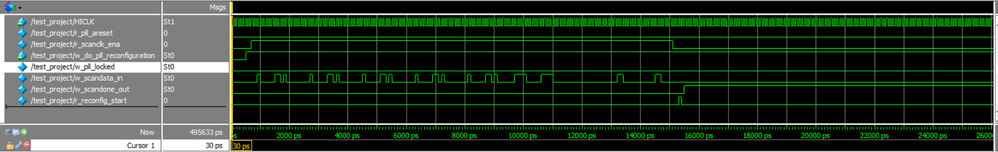

You can see that c4-c1 are loaded with zero counters, only c0 is being initialized.
Above picture: putting same "valid" settings to all the PLL channels does not make difference - scandone still does not return low.

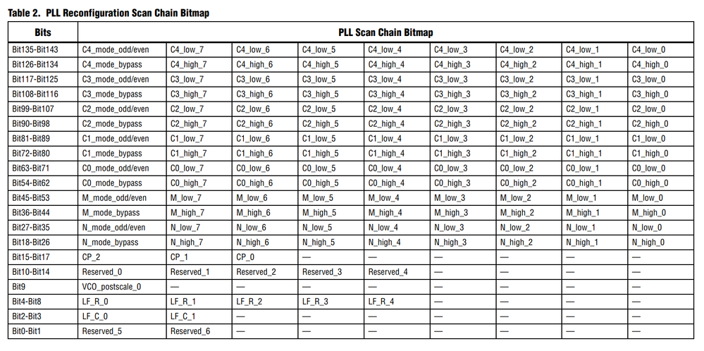

Unfortunately the list of registers above does not have any enable/disable bits for specific PLL outputs (like we have checkmarks in megawizard). May loading zeroes into the counter prevent scandone to complete?
