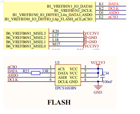

3 years agoBurn FLASH EPCS16 successfully, but the FPGA EP4CE15 does not start after the power is turned on.
Quartus 14.1
WINDOWS 10
EP4CEF15I7N
EPCS16
MSEL:1001:AS STANDARD 3.3V
It works normally when I download the .sof file.
I replaced FLASH, FPGA, USB blaster cable and computer, and t...
