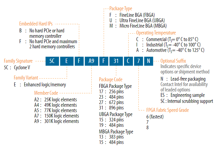

There is a three page document "Altera Device Package Information" (copy att.) that shows two options for solder ball composition for the 5CEFA5U19I7N part: "Regular" is 63% Sn/37% Pb and "Pb-free" is 3% Sn.
How does one specify the solder ball option when ordering this part? Thanks!

    Thank you for the help with my case. I understand from your reply that the "N" suffix specifies Pb-free packaging. Would ordering the part without the "N" suffix - that is, ordering the part number 5CEFA5U19I7 - result in parts packaged with the 63Sn:37Pb solder ball composition? This was an option highlighted in a package information document (copy att.).

    Sorry for the dela, for your information, the one that specify the solder ball option when ordering is the suffix. For an example 5CEFA5U19I7N. The N suffix is PB-Free packaging.
    Hope that answers your question.
