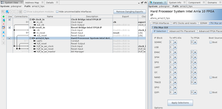

4 years agoArria10 SoC Devkit FPGA UART Guide
Hi, I’m trying to get worked Arria10 SoC Devkit’s FPGA side UART in FPGA side only. It seems that it is connected to HPS’ shared I/O pins. These pins have multiple signals and they must be choosen w...
sstrell
4 years agoYou chose "To FPGA" so the conduit is including those extra signals. I think you have to enable the UART under "To HPS I/Os". Or if you indeed want the UART to go to the FPGA, you don't have to use extra signals you don't need.
