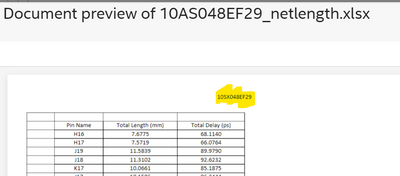

The pin package netlengths from the file you sent me back on 3/14/22 (10AS048EF29_netlength.xlsx) has the name of the worksheet different than the device name ( 10SX048EF29 ).
Would you please verify if the supplied spreadsheet and pin delays are for the Arria10 device 10AS048EF29 requested?

    I will check the file in the zip file for this device and verify that they are the same. If not, I will use the lengths from the zip file.

    I am Aqid, and I am not the person who supported you before. However, from what I understand, you are confuse because the file you got have a different name on it.
    From my checking through this link: Net Length Reports, there are net length information for 10AS048EF29 that you can download from Intel® Arria® 10 Net Length Information zip file.
    Would you mind check on that? If it the same with the document supplied that you have, I assume it is correct document that you are looking for.
