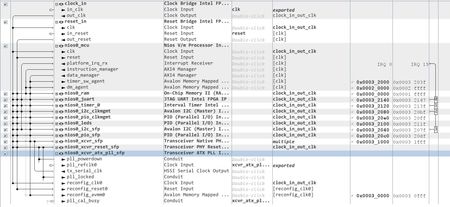

In all our transceiver example designs with Nios II/NiosV We have used a custom component to access the dynamic reconfiguration interface of the transceivers called reconfig_mgmt_hw.tcl directly. So if you instantiate this in your .qsys system you have direct access to the transceiver configuration interface. I suggest you have a look at the demo designs. For A10 you can find them here :

I have implemented the component you mentioned, but unfortunately it does not work. I have the same error: The register Bit 0x280[2] stays at 0x1, i do not get the control over the reconfiguration interface... The memory area looks exactly like shown in my first post.
I tried it with Nios II and V there was no difference.
Why can't I get control over the reconfiguration interface? Is it possible that the so-called PreSice is not working properly?
