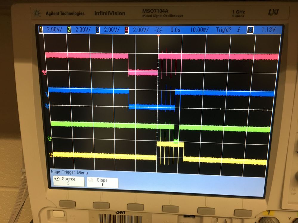

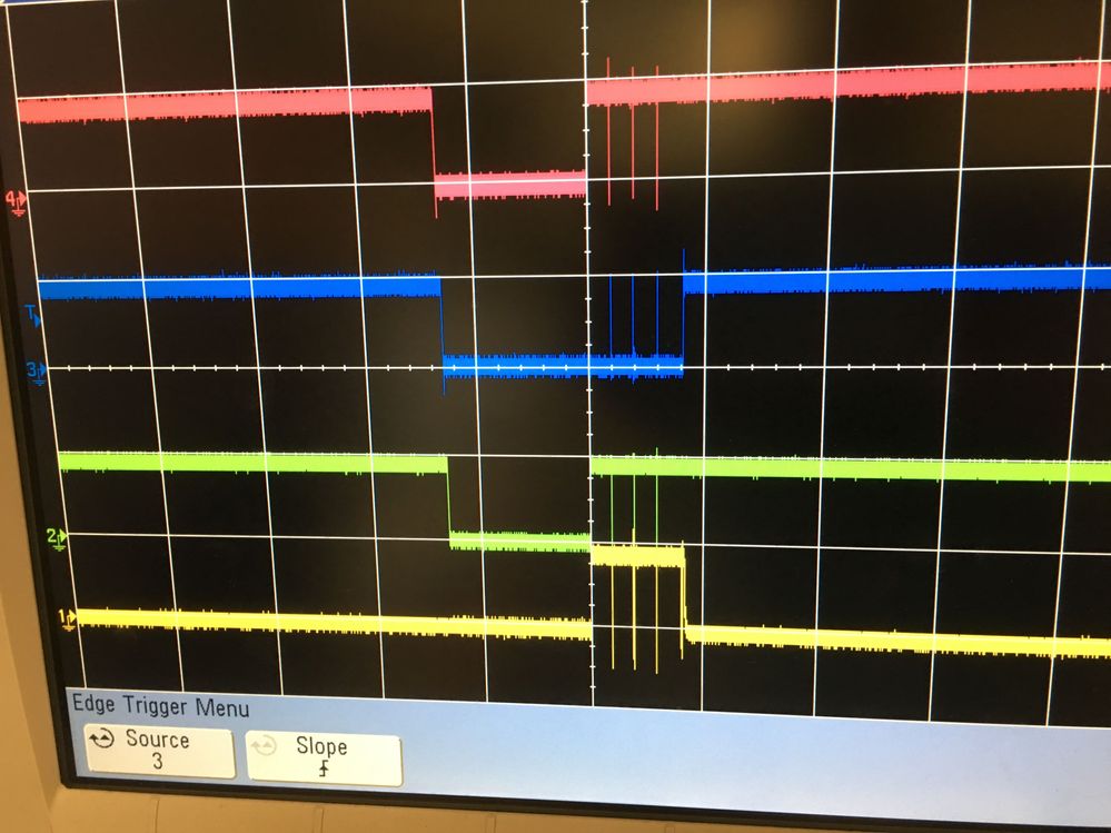

    For the screen shots here are the signal names:
    CH1: TCLK
    CH2: TDO (goes low with TDI/TMS right away in not detectable board)
    CH3: TMS
    CH4: TDI
  • KBrit1's avatar
    KBrit1
    Hello YL,
    Unfortunately no I cannot program with a SOF. After a board is programmed the first time, it is no longer recognized by the JTAG programmer. I have attached screen shots of the JTAG signals on both a good and bad board.
