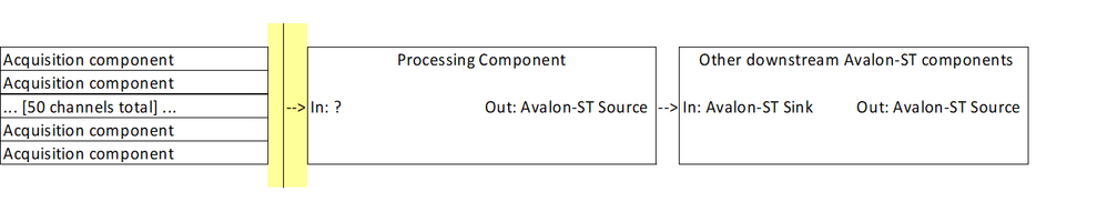

The component to acquire each channel of data is done and works fine in simulation and hardware. I now need to multiplex 50 components' data output into a processing component. The processing component will then expose an Avalon-ST source for downstream components to consume its data. I'm unclear/undecided on a reasonable approach to do this.
High level guidance / suggestions are appreciated. I can see either programming a mux / arbiter in HDL, or trying to use QSys to do it at a higher level. For the QSys route is it even feasible?

  • sstrell's avatar
    sstrell
    This could all be done in Platform Designer (formerly known as Qsys). The inputs can be physical and/or logical (using the channel signal) Avalon-ST channels. Platform Designer includes Avalon-ST components, including mux/demux, for routing data.
