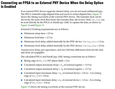

Hello, I just feel strange with AN477 doc below:
https://www.intel.com/content/dam/www/programmable/us/en/pdfs/literature/an/an477.pdf
page 12
why the
Calculated output maxi...
- 6 years ago
This is because
1) The multicycle assignments are used to create a setup relationship of 0ns and a hold relationship of -1/2*period.
2) The value for set_output_delay -max is now negative due to the 0ns setup relationship set by the multicycle then the setup requirement (max data delay).
