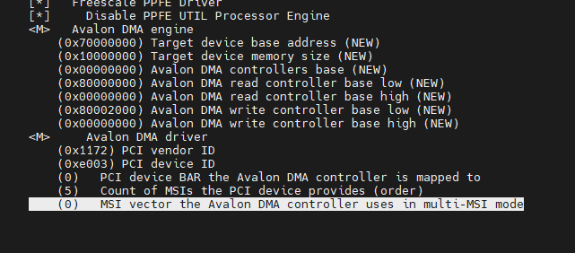

    I am not quite sure what is your question, but here is some explanation (I updated my previous message as well):
    avalon-dma - DMA engine driver that provides generic interface to the Avalon DMA engine;
    avalon-drv - sample driver that uses avalon-dma engine interface;
    avalon-drv-tool - sample user-level utility that uses avalon-drv interface to execute DMAs;
    The Linux version used is upstream v5.3-rc8.
    It is not big deal to backport it to any earlier version.
    HTH
    Thanks!

    Here is some explanation:
    avalon-drv - sample driver on top of a custom A10 design (see Alaric board link below) that uses avalon-dma engine;
    avalon-drv-tool - user-level sample utility that uses avalon-drv interface to execute DMAs;
