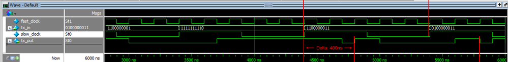

The 10-to-1 serializer is driven with two external clocks. I am feeding the input on the rising edge of the slow clock and 400ns later (in ModelSim at least) I get the serialized output out of Altera's Soft LVDS block. Each individual output state is aligned with the fast clock, but I do not see any output clock that I can use to tell the receiver when a new block of data begins. Where do I get a slow clock signal that's aligned with the SERDES output start?

I am using an ALTPLL block to create the basic signal clock C0 and a secondary C1 clock which is 5 times faster (according to Soft LVDS documentation). Each channel goes into an Altera LVDS instance (configured for external PLL) along with the two clock signals. Running the whole thing in ModelSim I see the expected data going in an coming out. The problem is, where can I grab a clock that is synchronized to the LVDS output? Can I rely on the simulation and add a 400ns delay or add another slow clock output with a 144 degree phase shift? Those ideas don't sound too great, so what is the recommended solution?
