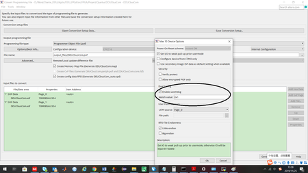

6 years agoAfter watchdog for dual-config is enabled, the FPGA seems like not work properly every dozens of seconds. Why?
FPGA communicates with another FPGA with PHY chip. Normally(watchdog enable checkbox not checked), the PHY link led is always off when communication is good. While after I enble watchdog for dual-con...

The write data X"00000003" will assert both trigger reconfiguration and reset the watchdog timer. The write data should be X"00000002" as this will set the bit 1 reset watchdog timer only.
