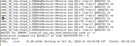

6 years agoAfter simulating stratix10 emif Ip, I found if I try to do simulation for more no. packets then an error message appears. After further debugging I found the issue is with one of library created by quartus.
I am using ncsim tool for simulation. If i try for less packets lets say 50 it goes well. but for more transaction is shows error. I found the error is caused by one of library names fouteenm_ver. A...

I am support AE from Intel and this forum is Intel official platform where we used to support customer issue.
- Can you try to duplicate the issue using DDR4 example design instead of your own design so that it will be easier for me to debug in house as well ?
- Also, have you try DDR4 IP design generated with latest Quartus version which is v19.3 ?
