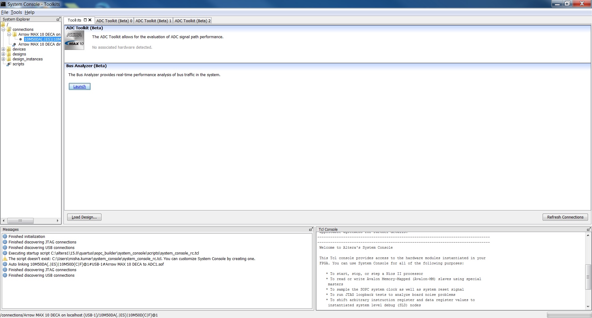

ADC Toolkit is not able to detect associated hardware on MAX 10 DECA board
I am trying to use the ADC on MAX 10 DECA board. I am trying to provide a signal from a function generator and used Qsys to setup my ADC exactly as explained in the tutorial video https://www.youtube.com/watch?v=0oo1rfa-4xk. When i open system console, I load my .sof file in the load design option and still my Altera toolkit is not able to detect hardware.
Attached is the screen capture of my system console.
Please let me know, what am i doing wrong?

    Hey, Yeap, I did solve it. I found that, you need to EXTREME carefully follow the youtube tutorial. At 11:30 you add files to the project. I skipped this part, and this is why I had problems with detecting my board afterwards. I hope this will help you...
