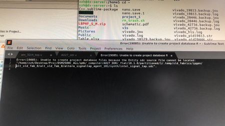

客户在Linux下,使用18.1pro版本,在添加了signaltapii后,编译就报错,错误如上,这是什么原因了?

6 years agoHi Ryan,
This error is due to wrong "intel_signal_tap.sdc" path as it is not in project directory. You can manually try to copy the "intel_signal_tap.sdc" and paste it in your project directory or you can navigate to the path where contain intel_signal_tap.sdc file(as stated in the error message), open it and save as (save to your project directory) and recompile. Let me know if it works, thanks
