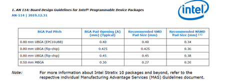

How can I know if 10M16DCU324I7G package belongs to which one in below table?

5 years agoThanks, so I should set PCB solder pad size = 0.34, solder mask = 0.4, right?

Please follow the recommended pad size on of your device from the table.

Is my understanding of the table correct?
- AminT_Intel5 years ago
Yes. Please refer to page 6 of this document: https://www.intel.com/content/dam/www/programmable/us/en/pdfs/literature/an/an114.pdf
