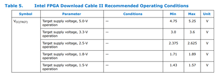

The Table 5 , page no: 12 of the below document shows the recommended operating conditions.

I do see on page 3 that it says the supported voltage standards include single-ended I/O standards from 1.5V to 3.3V
However the Table 5 on page no: 12 that you mentioned lists all the single-ended I/O standards from 1.5V to 3.3V EXCEPT for 3.0V which is why I am unsure. The voltage standard specified on above thread is not listed in the table while every other voltage standard is. I was wondering if perhaps 3.0V is not considered a standard single-ended I/O standard from 1.5V to 3.3V.
Can you clarify, are you saying that the 3.0V Voltage standard really should have been included in table 5 on page 12, but was left out by mistake?
