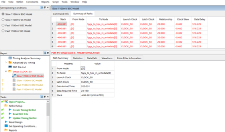

Hi, I am not sure how to describe the problem to be written in the title. So I have a 150mb dataset in .txt, it looks like: 0.123
0.254
0.956
... got like 3 million rows. I am using the FIFO in...
EBERLAZARE_I_Intel
6 years agoHi,
Looking at this issue, it might be caused by the timing issue of your design.
Is the design your own or from a tutorial/ websites that you selected?
Which Quartus version are you currently working on? Could you share your timing reports in Quartus here?
