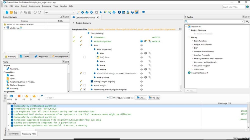

Please try again with template of the same version of Quartus Pro which is installed on your machine.
Here is Q19.1 Pro screenshot,
Please let me know if you have any different issue.
