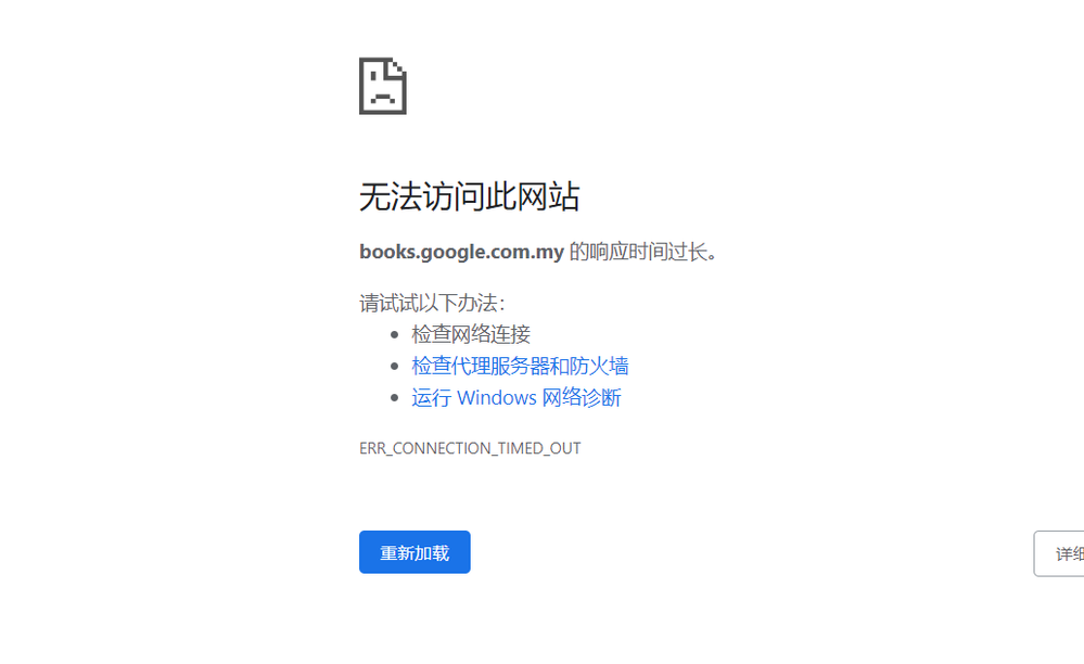

- AMa
The google link cannot open...
- KhaiChein_Y_Intel
I tried again, the link can be opened. Could you share what did you see when you open this link?
KhaiY
- AMa
I cannot open google link in China...
