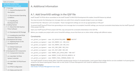

Hi, I am trying to compile my own design into a Stratix 10 GX development kit and I keep getting an error that the VID settings are not complete. I searched the web and found information for the St...

Upon checking with team members, S10 GX dev kit do not provide VID setting in reference design. From my findings, VID setting is provided in Intel Stratix 10 TX SI Development Kit https://www.intel.com/content/www/us/en/programmable/products/boards_and_kits/dev-kits/altera/kits-s10-tx-si.html

6 years agoThanks. I checked the settings for the TX board and modified them to fit the GX board and now it works(!). I used:
Thanks again.
