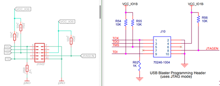

How to solve the problem "Unable to scan device chain" ? I make board by referent Max 10 FPGA Evaluation Board When i will to auto detect... Sometimes see the device ( meybe ). I don't know how...

I observed that you are using 1K Ohm pull up resistor on nStatus, CONF_DONE and nConfig pin. May I know if it possible to change it to 10K ohm resistor?
The other thing is that could you make sure that your Max 10 pin connection to the board is good?
