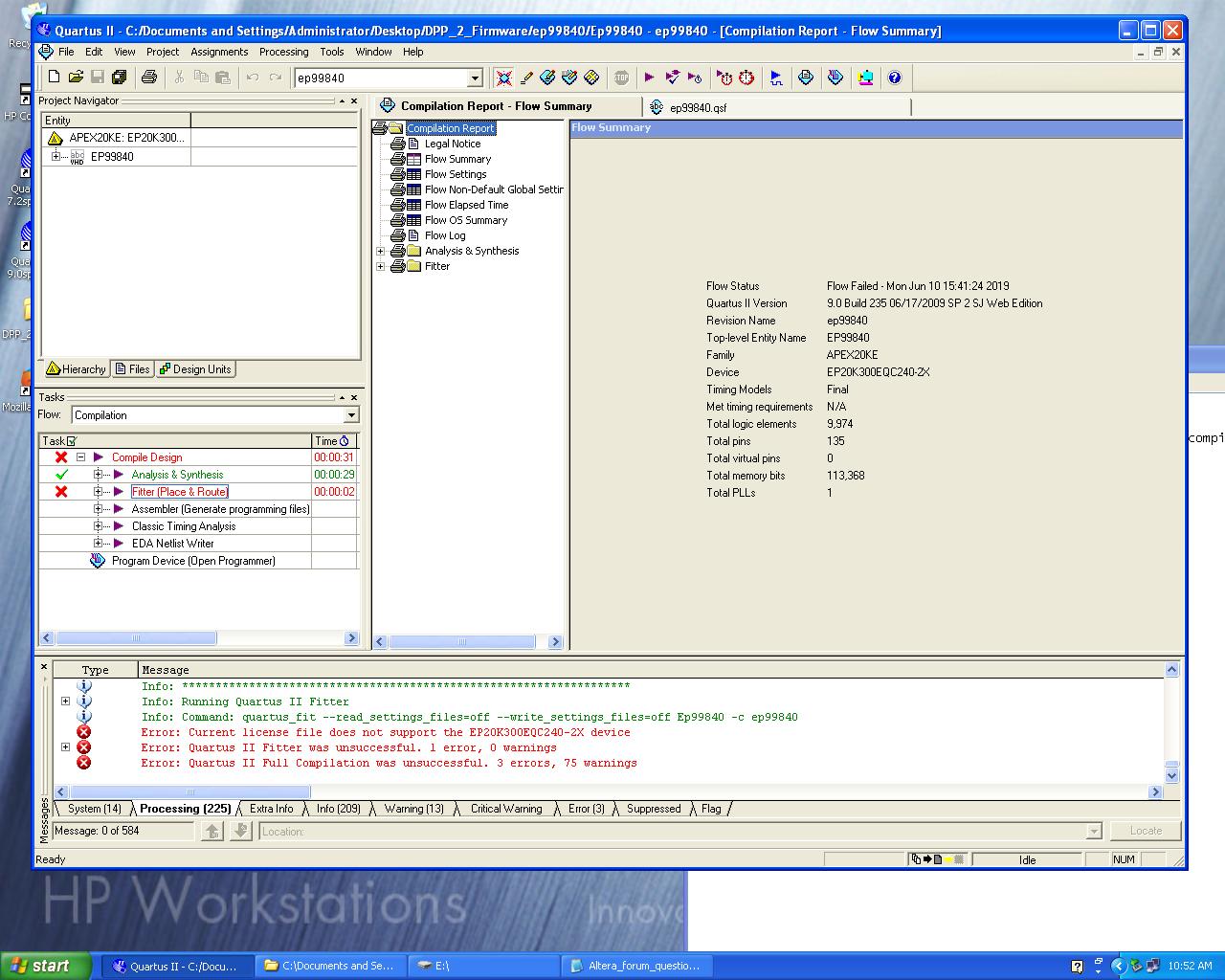

Unable to compile EP20K300EQC240-2X device using Quartus 9.0sp2 Web edition on Windows XP.
APEX20KE devices are obsolete, WIndows XP is not supported...but unfortunately, I need to build the pof / sof file to reverse engineer the design. The error I keep getting is "Error: Current license file does not support the EP20K300EQC240-2X device", even though I generated the web license file using my NIC id. The error occurs at the Fitter stage.

The Error screenshot and the license file that I am using is attached

It does need a license, contrary to what is advertised. When I had reported the error, the XP machine had absolutely no Quartus license. The design was not compiling, as described in the original complaint. Then, I generated a companion license from the Intel Self Service Licensing Center (I included the XP Machine's NIC ID). I copied the license locally on to the XP machine, and pointed the Quartus 9.0sp license to the same. It worked right away.
