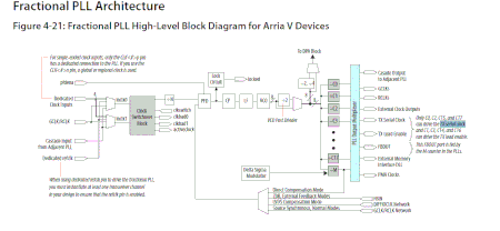

6 years agothe tx_serial_clock and tx_load_enable signal of one exteral can not drive the lvds_tx in different BANK of Arria V?
Hello everyone, I have one problem is that I need several LVDS pairs for high-speed data output, I only can select the lvds pairs in diffent bank because of layout restrictions. I chose the outp...

6 years agoHello Lambert,
There will be option in PLL to compenstate the phase or you can use the source syn options too.I cant give the definitive number but it is good to try the options
