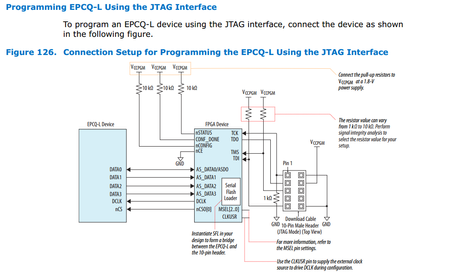

Hello: The EPCQL256F24IN program is unsuccessful, the FPGA is Cyclone@10, I used the following scheme: There are two questions: A、is it right the scheme above for configuration the E...

A -> Yes, this scheme shows Connection Setup for Programming the EPCQ-L devices.
B -> JTAG, as title of figure itself mentioned that.
You can program EPCQ-L devices using either Active serial programming interface or JTAG interface,
Refer the 'Programming EPCQ-L Devices' from link below,
https://www.intel.com/content/www/us/en/programmable/documentation/vua1487061384661.html#sam1403482956821
