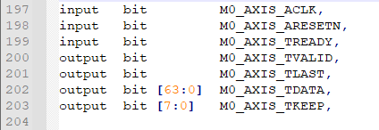

There is a FIFO in my RTL code which is converted to an IP in Platform Designer.
I connect my IP to NIOS II in PD.
The FIFO reading interface is axi_stream. Please see the following picture.
I would like to add a DMA which can transfer data from the FIFO to NIOS RAM.
is there a suitable DMA for my design?

It is suggested to use the mSGDMA instead of the DMA.
