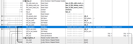

Hi everyone, I am looking for a way to get data from the mSGDMA IP Core in FPGA portion and do some calculation with that data in HPS. The problem is that I have never worked with FPGA-to-HPS ( F2H ...

There is an example design that demonstrate the data communication between FPGA and SDRAM controlled via the HPS:
https://rocketboards.org/foswiki/Projects/DatamoverCopy
- Is it possible to use that On-Chip RAM? Or it is used for others purpose?
>It is possible if your software code is smaller than the amount of memory available on the onchip RAM. It can increase access performance.
- If yes, is it wise to use it? 😕
> Well, you cannot utilize the entire on-chip RAM blocks just for storing program code, thus needing additional RAM blocks depending on the complexity and functionality.
- How can I read the data from F2H? Do I need to initialize L3 Interconnect to get the data?
>The example design of the Datamover will help you a lot.
