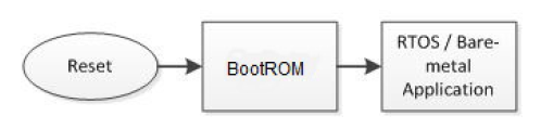

I am trying to run bare metal application from SD card using below boot method.
I have prepared SD card to boot preloader according to procedure explained in one of the Rocketboards page.
