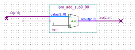

Good morning, 'm trying to simulate a simple three-bit adder with 1 but as soon as I launch ModelSIM and force the input signal to 000 for example, the output signal remains in z state. I also tried ...

Did you parameterize and generate this?
https://www.intel.com/content/www/us/en/docs/programmable/683490/24-1/parameters-22365.html

1 year agosorry, the right figure is this

1 year agoDid you parameterize and generate this?
