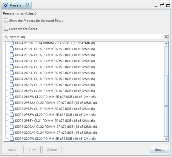

Based on your criteria of the RDIMM, the preset setting will limit to RDIMM that has 2 rank x8 organization and 8GB density.
There are some RDIMM that available based on preset setting but I'm not sure if it's available in stock or not.
Some RDIMM 8GB 2 rank x8 2666-speed grade:

- AdzimZM_Altera
Available preset for RDIMM in Quartus
