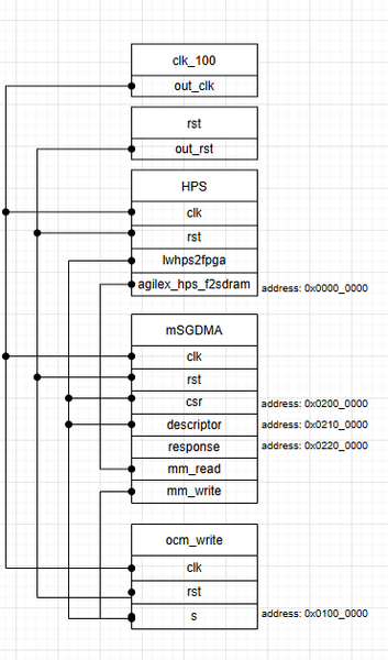

I am in the process of learning about communication between SDRAM and OCM via DMA, using the Agilex-5. The idea will be to write 0xdeadbeef to the SDRAM, then initiate a DMA transaction between the ...

Tried this with a connection to the altera ace5 cct and it worked well.
I suppose it is an issue with cache after-all!
