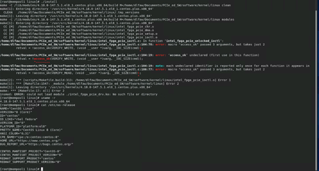

Hi All I have s10 DX kit and I am attempting to validate PCIe.sof file which SW package comes with. I loaded sof file in the kit and device is visible in 'lspci' command. (there was one device wit...

6 years agoHi Sir,
Please try the sof as attached in this thread - https://forums.intel.com/s/question/0D70P000006hLBZ/system-hangs-while-testing-intel-fpga-ptile-avalon-memory-mapped-avalonmm-ip-for-pci-express-design-example-user-guide-example-design
This sof is verified work at our side and also the customer side.
