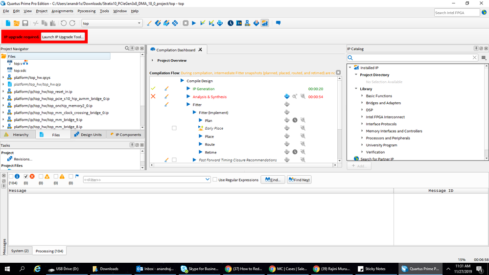

    There may be some issue with design template, for me also experienced same behavior for one machine but for another machine I could able to workaround like First I downloaded the 'pcie_example_design_18_1_0_222.par' then open Quartus 19.1 Pro & 'Open Project..' & browse the *.par file.
    please refer the below screenshot.
    Vicky
