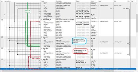

1. In Qsys read from DCFIFO write to DDR2 SDRAM using DMA fails. In other words I want to write ADC samples into DDR2 SDRAM using DCFIFO+ DMA+DDR2_controller.
[NAli1]: Can you try to read/write from DCFIFO + DMA + DCFIFO? Is it pass? The reason I ask because we want to know which side is causing the problem; is it from the DMA or the DDR2 controller.
2. In Qsys I add another DMA to the existing block I successfully write to and read from the same DDR2 onboard SDRAM by programming the DMA but; it is slow! 64 MB/sn.
[NAli1]: As I understand it, case #1 failed to perform read/write while case#2 can passed. What is the main configuration different between case #1 and #2 ?
