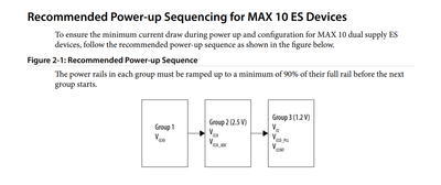

Hello, I have selected the FPGA part number 10M08DAF256I7G for our design. I would like to confirm whether a specific power-up sequence is mandatory for this device. If a power-up sequence is requi...
