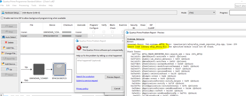

However, the .jic file that is generated after following those steps causes the Quartus programmer to crash as soon as I add the .jic file.

The .jic file was generated in Linux (Quartus Prime v20.1.1 Build 720 11/11/2020 SJ Standard Edition).
I was trying to use that .jic file in Windows (Quartus Prime v20.1.1 Build 720 11/11/2020 SJ Standard Edition).I tried generating the .jic in Windows (instead of Linux) and saw that the programmer tool no longer crashes when I add the file.
