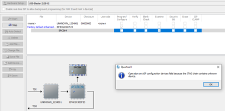

This question is related to booting a Cyclone IV FPGA from flash memory. Previously, I used the S25FL064P device and would generate a .jic file using the ECPS64 preset and was able to successfully p...

Problem solved.
The .jic file was generated in Linux (Quartus Prime v20.1.1 Build 720 11/11/2020 SJ Standard Edition).
I was trying to use that .jic file in Windows (Quartus Prime v20.1.1 Build 720 11/11/2020 SJ Standard Edition).I tried generating the .jic in Windows (instead of Linux) and saw that the programmer tool no longer crashes when I add the file.
