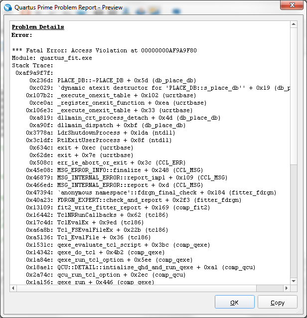

I'm integrating my SoC and FPGA projects. I got error message below. Any ideas or suggestion?
Problem Details
Error:
*** Fatal Error: Access Violation at 00000000AF9A9F80
Module: quartus_fit.exe
Stack Trace:
 0xaf9a9f7f:
     0x236d: PLACE_DB::~PLACE_DB + 0x5d (db_place_db)
     0xc029: `dynamic atexit destructor for 'PLACE_DB::s_place_db'' + 0x19 (db_place_db)
    0x107b2: _execute_onexit_table + 0x102 (ucrtbase)
     0xce0a: _register_onexit_function + 0xea (ucrtbase)
    0x106e3: _execute_onexit_table + 0x33 (ucrtbase)
     0xa819: dllmain_crt_process_detach + 0x4d (db_place_db)
     0xa90f: dllmain_dispatch + 0xbf (db_place_db)
    0x3778a: LdrShutdownProcess + 0x1da (ntdll)
    0x3c1df: RtlExitUserProcess + 0x8f (ntdll)
     0x634c: exit + 0xec (ucrtbase)
     0x62de: exit + 0x7e (ucrtbase)
     0x508c: err_ie_abort_or_exit + 0x3c (CCL_ERR)
    0x45e08: MSG_ERROR_INFO::finalize + 0x248 (CCL_MSG)
    0x46879: MSG_INTERNAL_ERROR::report_impl + 0x109 (CCL_MSG)
    0x466ed: MSG_INTERNAL_ERROR::report + 0xd (CCL_MSG)
    0x47394: `anonymous namespace'::fdrgn_final_check + 0x184 (fitter_fdrgn)
    0x40a23: FDRGN_EXPERT::check_and_report + 0x2f3 (fitter_fdrgn)
    0x13109: fit2_write_fitter_report + 0x169 (comp_fit2)
    0x16442: TclNRRunCallbacks + 0x62 (tcl86)
    0x17c4d: TclEvalEx + 0x9ed (tcl86)
    0xa6a8b: Tcl_FSEvalFileEx + 0x22b (tcl86)
    0xa5136: Tcl_EvalFile + 0x36 (tcl86)
    0x1531c: qexe_evaluate_tcl_script + 0x3bc (comp_qexe)
    0x14342: qexe_do_tcl + 0x4b2 (comp_qexe)
    0x1a84e: qexe_run_tcl_option + 0x5ee (comp_qexe)
    0x18ae1: QCU::DETAIL::intialise_qhd_and_run_qexe + 0xa1 (comp_qcu)
    0x2a74c: qcu_run_tcl_option + 0x2ec (comp_qcu)
    0x1a156: qexe_run + 0x446 (comp_qexe)
    0x1b28a: qexe_standard_main + 0x26a (comp_qexe)
     0x2052: qfit2_main + 0x82 (quartus_fit)
    0x149b8: msg_main_thread + 0x18 (CCL_MSG)
    0x16061: msg_thread_wrapper + 0x71 (CCL_MSG)
    0x20d90: mem_thread_wrapper + 0x70 (ccl_mem)
    0x13f3d: msg_exe_main + 0x20d (CCL_MSG)
     0x2918: __scrt_common_main_seh + 0x11c (quartus_fit)
    0x1570c: BaseThreadInitThunk + 0xc (kernel32)
    0x5385c: RtlUserThreadStart + 0x1c (ntdll)
End-trace
Executable: quartus_fit
Comment:
None

  • Hi,
    How did you get this error reported? Was it during Quartus Compilation?
    Are you attempting to load/combine different version of Quartus project files?
    • User1580871742356367's avatar
      It happened only when I was integrating FPGA subsystem with HPS subsystem.
      FPGA subsystem/project alone is fine and HPS subsystem/project is fine too.
      The fitter was complemented without error while the error message pop-up.
      I could run the Timing Analysis and Assembler manually afterwards.
      I’ve also tried on different computers and it’s the same.
      Hope to get some feedback ASAP! Thanks.
      • EBERLAZARE_I_Intel's avatar
        EBERLAZARE_I_Intel
        I believe your files from both project are not in the correct directory when compiling, things to try you may want to place the .v files from both projects in the top-level folder and re-compile.
