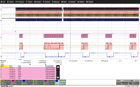

The operation sequence to erase a sector from my code is:
- ENABLES write operation (operation Code: 0x06)
- SEND erase command (OC: 0xD8 for "sector" erase)
- WAIT for WIP flag clear reading status register (OC: 0x05)
- DISABLES write command (OC: 0x04)
Note that the partial erase mentioned in the previous mail, is not true because it was due to a wrong read in ECLIPSE: the erase operation alway has no effects on the current sector.
